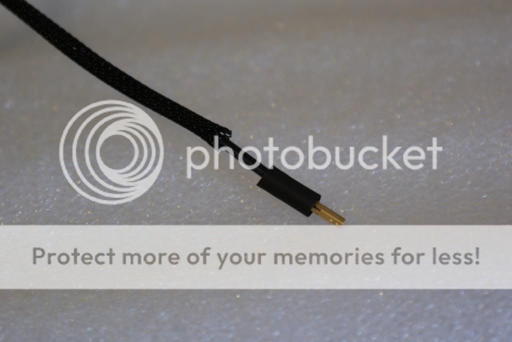

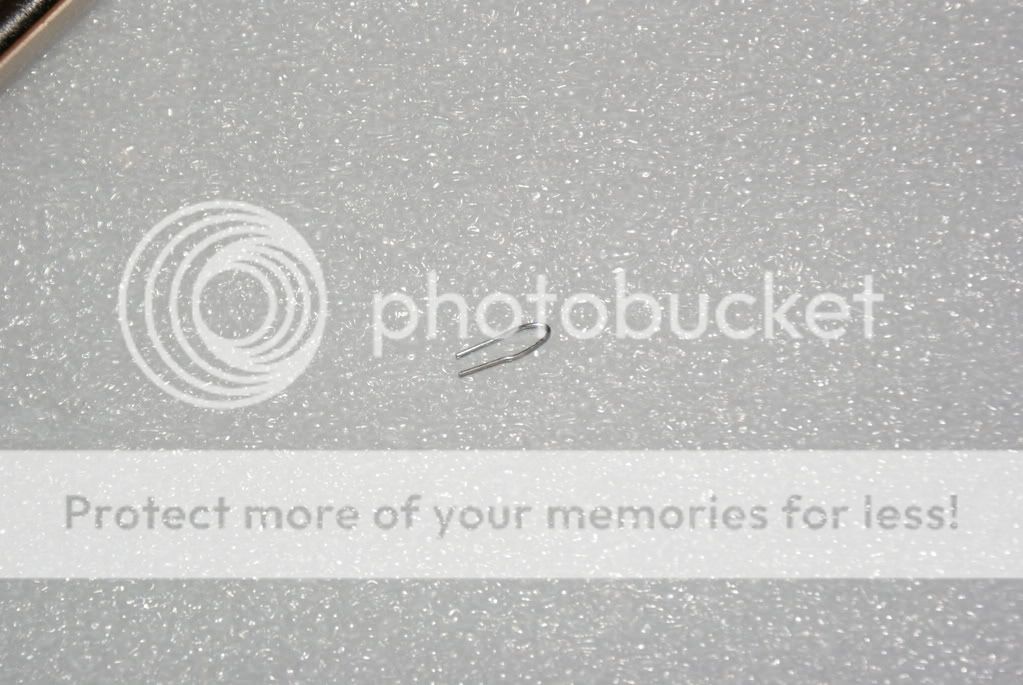

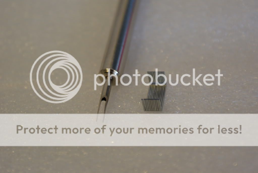

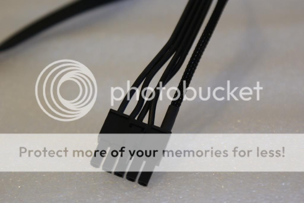

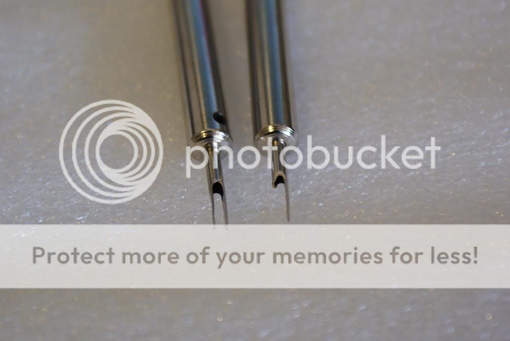

I find that two together once bent into shape are a perfect fit for removing those pesky plugs and if you break them...simply get a couple more:thumbup:

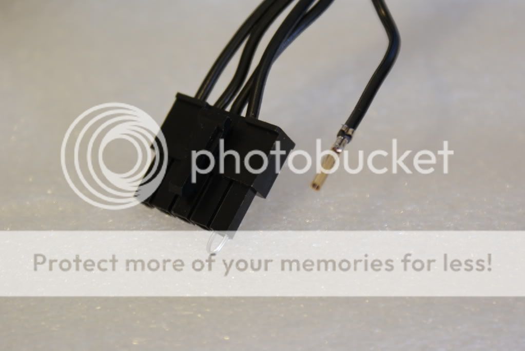

What you do is simply place either the pin remover or staples in the end of the plug like so
and then push them in as far as they go (this is where you are likely to break the tools) and then pull on the cable. You shouldn't need too much force but some are a little harder to remove than others.
example of two removers one broken
Just pull on the appropriate cable

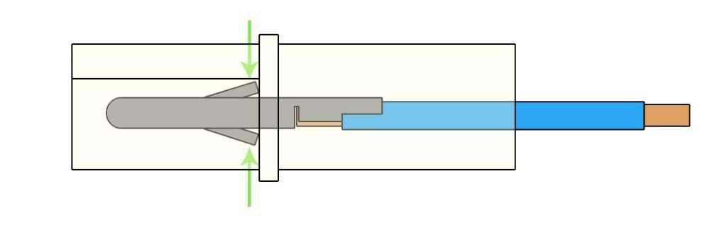

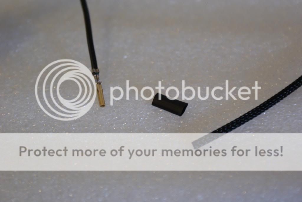

To demonstrate your goal at this step Moogle drew up the below diagram to better help explain the process (image courtesy of Moogle @ Hexus.net)
At this point you can measure up and cut the sleeving to cover the length of the cable - NOTE - that you will need to allow slightly more sleeving than what appears to be needed as when you slide the sleeving over the cable it looses some length as it expands to fit the sleeving.
The next step from this point is you take some heatshrink cut to an appropriate length so that when you heat it up it will cover both the end of the sleeving but a section of cable as well. You take this and slide it onto the cable followed by the sleeving.
Once you have moved the sleeving almost to one end guide the heatshrink over the end of the sleeving so that there are no stray wires sticking out.
Now this part will require some nimble fingers and patience if you are using 1/8" heatshrink with 1/8" sleeving as it takes a little bit to get the heatshrink on. But once it is on there it is less likely to come off than if you had used a larger size that doesnt shrink enough to get a firm grip.

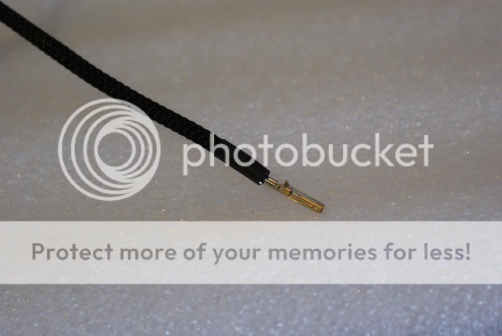

Once you have done this end you can either use a heatgun or the missus hair dryer :up: to heat the shrink up so that it keeps the sleeving in place. Do the same at the other end and once that cable is done simply click it back into place within the plug like so.

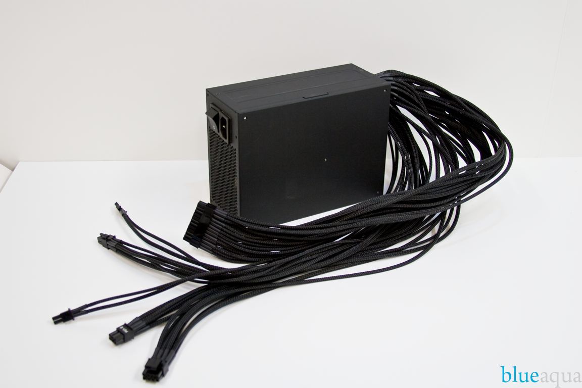

a evo kako izgleda sa pravim sleeve_om (MDPC-X)
